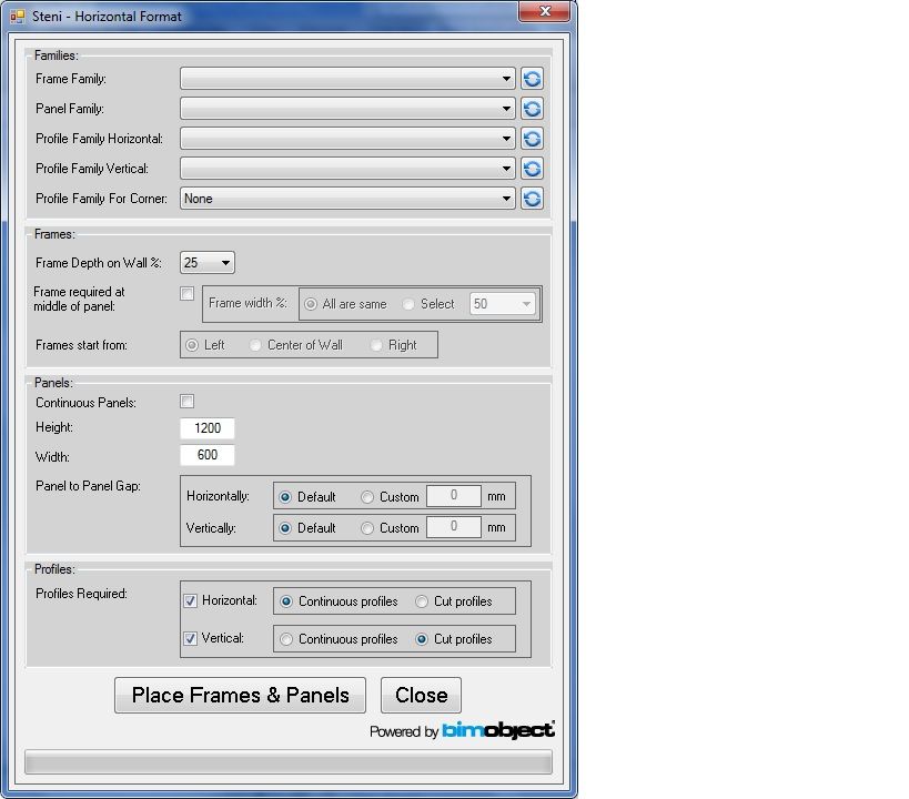

Hi, Can you please tell me how to change the name of the files in Steni, so that you can add in the Steni app into your revit program? I am using Revit 2018 and it seems that the Steni file is for 2013, 2014. Please help me to solve this problem. I attached the error detail.

Hi can you help ? The frame family doesnt exist in my revit 2015. Thank you

Here is the 2017 version and install instruction.
See attachment.
They are working on a 2018 version.

Message 16 of 18
thank you very much for reply, have install it and is working perfectly now.regards
