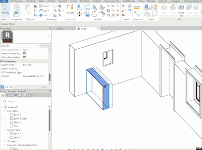

They will show in one of the following three cases
  • The wall is cut
  • The wall is converted to parts (and view set to show Parts or Both)
  • Create a model group and attach a detail component to it
Use whichever it suitable or manually draw the lines
