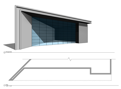

Hi community,
Hope you all are doing great!!
This is my first post.
Here is my question:-
"Can we create a sweep/reveal on the cross section of a wall with/without Dynamo script? ;If yes, I will be more than happy to get ideas on HOW? "
Please see the images to understand the shape and senario.
Thanks!

hj6636572
Sorry,here are the images
Looks like you want to cut the ends at an angle.  You can get the with a void cut, assuming it's a System Family Basic Wall.   Model the Void In-Place, Cut the Wall, and press Finish to exit In-Place Sketch Mode. Bada bing.
Actually, isn't this what's going on in that photograph?
