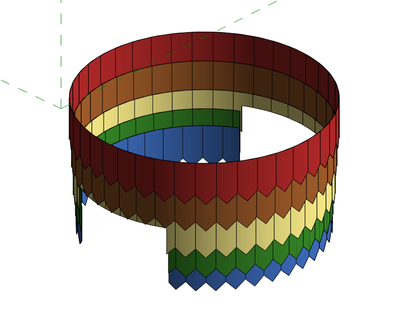

I have a similar question. Having just read through a lot of threads I can't find the answer although this feels closest.
As the original post, within a host family (not a project) I would like to cut multiple nested families that are part of a parametric array. I have tried face-based void families but this does not work because the solids are an array and the families needing to be cut will vary depending on the total height of the panel.
This is for a cladding panel (host family) made up of angled boards (nested family) that I then need to square off at the top and bottom with a void in the host family to form the final panel. Screenshot and family attached in R2024. Thanks!
