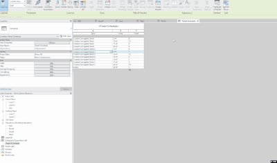

What @barthbradley  suggested is brilliant (only mullions) but what if you want to quantify panels...right?
Several ways to do so
  1. use a pattern based component on a divided surface
  2. add a void in the custom panel to cut the top at an angle
  3. or even simply cut and trim the curtain wall to the shape you desire (USING only Panels similar to the below GIF)...ie: what has been stated on custom panels working only for rectangular shaped walls is not entirely true. They can be cut and shaped using a mass form

Hi, sorry for digging up this subject again, but I 've watch the gifs 20 times I can't figure it out :
How did you make the trim or the cut-out in your custom pannel ?
(From my understanding, yours is a simple Metric Curtain Wall Panel Family with a kind of array of extrusion and maybe a what seems to be a void cut with a angle parameter ?)
The only way I found is to cut the pannel with a Mass in place, simple, but it does'nt substract the area in the property, so it's pretty useless. What am I missing ?
