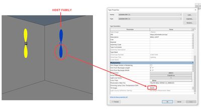

Hi i was just wondering if is possible to add 2 photometric files, considering that there is 2 lights in opposite directions.

Try Nesting  it as a Shared Family

Nest a Shared Light Family  into another Light Family (the "Host")  and then load and place an instance of the "Host" Family in the Project.  Now TAB-Select on the "Host" Family to select the Nested Light Fixture, and once it's selected you will be able to edit the Photometrics of the Nested Light Fixture (and any other of its Properties)  independently of the Host Light Fixture.  Two Light Fixtures in one.  That is what you are after; right?
Message 5 of 22
- Create a light family (A), set it to Shared, add the IES
- Create another light family (B), load (A) in, place it twice (or mirror, copy, whatever works)
- Load (B) in project
Message 6 of 22
BTW: it's not necessary that the Nested Shared Light Fixture Family have anything more in it than the light source.

s3687147
when importing the photometric file it positions itself into a weird angle and also i am unable to pin the imported photometric file to the light (family).

You want it aimed upwards?  Change the Tilt Angle.

Sorry i have 1 and hopefully last question.
Is there  away of combining the photometric files as 1 ? the reason I am asking is because I need to have right details for the calculationsCapture.JPG
Message 16 of 22
Sure. Don't Share the Nested Light Family. Just associate its Photometric Parameters to the Host Photometric Parameters. You'll need a second Tilt Angle in the Host to control the angle of the Nested Family, if that's important.  Or just tilt it and leave its Tilt Angle unassociated.
