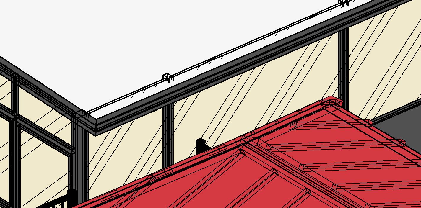

I’m having problems with my Revit file. 3D views and elevation showing random hidden lines.

Message 21 of 28
Toggle Visibility of your Imported Categories in the View under View Visibility & Graphics Overrides.
ON:
OFF:
Message 22 of 28
It took away some lines but not all of them, they are still there.
Message 23 of 28
It took away some lines but not all of them which is weird.
Message 24 of 28
You also have a rogue element. See if deleting it helps. I did.
this:
here:
Message 25 of 28
I did, and nope still the same.
Message 26 of 28
Reopen the Project with Audit checked.
Message 27 of 28
What is Audit, never seem that. What would it do to the project.
Message 28 of 28
Hey, it work man. Perfect. Thank you so much you a life saver.
