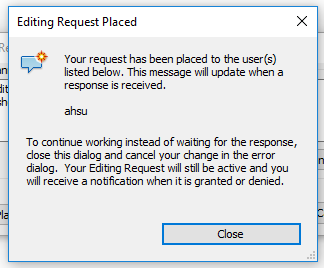

Now that will basically request permission from the user and will display this dialog:
That's not ideal, since now I am stuck waiting for their reply.
Is there a way to just RollBack, skip over that element and move on with the remaining ones?
