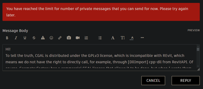

of the users asked me a question in a personal message about using CGAL in Revit. I tried to send him a reply, but first I got a strange error about invalid tag (to be honest, I get it when I try to send every response, for example in this forum branch), but here, when I click the "Post" button again, the error disappears and the message is successfully sent.
But when I try to click the "Post" button again to send a private message, a second error occurs, about exceeding the message limit at this point in time, although this was the first message I tried to send today.
In any case, now I do not have the opportunity to reply to the user with a personal message, and given that this information, I think, will be useful to everyone who has read this topic up to this point, I will post the answer here.
To tell the truth, CGAL is distributed under the GPLv3 license, which is incompatible with REvit, which means we do not have the right to directly call, for example, through [DllImport] cpp-dll from RevitAPI. Of course, GeometryFactory has a commercial CGAL license that allows it to be done, but when I wrote them an appeal asking about the license price, I received the following response:
