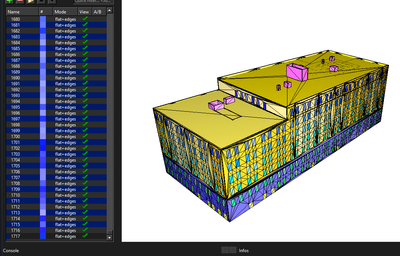

UPD: 16.10.2024
At the moment, I have managed to union 100% of 1717 solids (screenshot below)
by uploading to off-files and union them using CGAL. The result is an output off-file (it is in the screenshot below)
P.S: When trying to combine the Solids data through Revit, several dozens exceptions occurred about the inability to perform a Boolean operation on solid.
I checked in CGAL that the resulting mesh is correct, i.e. it does not have self-intersections, limits the positive volume, is correctly oriented, and is also a triangular, not a polygonal mesh.

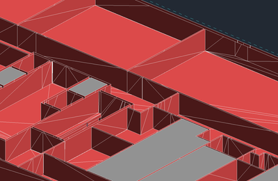

Based on this, I believe that the main problem lies in the verification:
if (v1.DistanceTo(v2) < 0.5 || v2.DistanceTo(v3) < 0.5 || v3.DistanceTo(v1) < 0.5)
	continue; // Пропустить такие треугольники
With such a check, of course, instead of Solid, we will get an Open Shell, as can be seen in the screenshot below:
If you make a check of at least 0.1
if (v1.DistanceTo(v2) < 0.1 || v2.DistanceTo(v3) < 0.1 || v3.DistanceTo(v1) < 0.1)
brepBuilder.IsResultAvailable()
 - always returns false
Dear @jeremy_tammik can I ask you or someone from the development team to clarify in more detail what the introductory conditions are for the grid source data? Minimum edge lengths, minimum face area, etc? Because at the moment it seems to me that such an accurate geometry in Revit simply cannot be built from such constraints.
