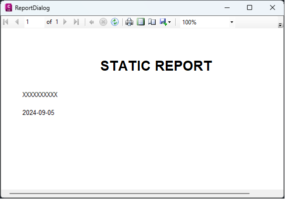

Here is what the report shows in the AutoCAD plugin's dialog form:
So, I think the error you got is because the report design does not have the parameter defined as the first picture shows in my this reply.

Yes, I can verify that the reporting plugin runs OK with C3D/Map 2025, but runs into error with plain AutoCAD 2025.
Since the error reports that it has something to do with Microsoft.CodeAnalysis.VisualBasic.dll, which is included in the ReportViewerCore.WinForm Nuget package and is outputted in the AutoCAD plugin folder. So, I searched AutoCAD 2025 installation folder. I found This DLL in AutoCAD 2025's Vertical project folder (...\AutoCAD 2025\C3D[Map]), but not directly underneath the "...\AutoCAD 2025\" folder.
In the ...\AutoCAD 2025\[Vertical]\" folder, there are these 4 dlls
Miscrosoft.CodeAnalysis.dll
Microsoft.CodeAnalysis.Scripting.dll
Microsoft.CodeAnalysis.VisualBasic.Scripting.dll
In the ...\AutoCAD 2025\" folder, there are only 2 these files (i.e. 2 xxxx.Scripting.dll files do not exist):
In comparison to the plugin's output folder (i.e. the dependency DLLs from the Nuget package are also included):
So, I did this 2 tests:
1. copy the 2 xxxx.scripting.dll files into ...\AutoCAD 2025\ folder and run the report plugin with plain AutoCAD 2025. It works and the error is gone.
2. Copy the 2 xxxx.scripting.dll files into the plugin output folder (make sure the 2 files do not exist in the ...\AutoCAD 2025\ folder, as this is the AutoCAD 2025's original state), and run the report plugin with plain AutoCAD 2025. It also works.
So, the conclusion is that when the .NET8 runtime loads the report definition (*.rcdl file), it needs either Miscrosoft.CodeAnalysis,Scripting.dll or Microsoft.CodeAnalysis.VisualBasic.Scripting.dll, or both. However, the Nuget package somehow does not include the 2 xxxx.scripting.dll files, nor does the AutoCAD 2025 root installation folder.
I'd consider it is a bug from the NuGet package. You can simply find the 2 xxxx.scripting.dll files from "...\AutoCAD 2025\Map[Cad\ScaRuntime]" folder into the plugin's output/deployment folder.
