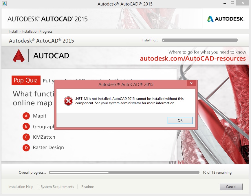

I am having problems AutoCAD due to my pc telling me that .NET Framework is not installed.
Now I know .NET Framework 4.5 is installed on my pc, I installed it my self but AutoCAD will not install..
I really need help to get this program installed on my pc because I am studying AutoCAD at the moment and I had to format my pc due to windows not starting up and I've formatted and reinstalled everything back onto my pc including all my drivers and I have updated all my drivers. Adobe After effects, Photoshop and a few other programs have installed with no issues.

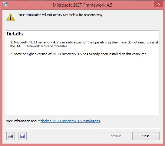

Thank you for the quick reply, but how do i now get 4.5 on? I have tried to install 4.5 full that I downloaded from the Microsoft website but tells me there is no need to install it, there is already this version on the pc.
