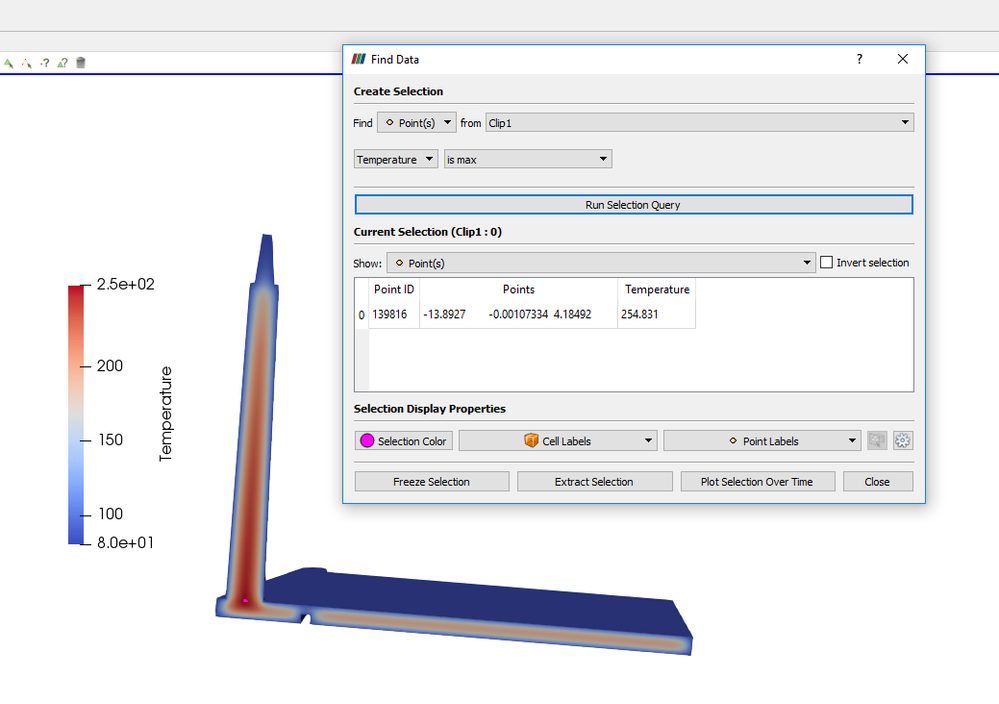

An alternative is to export Moldflow results to a format readable by ParaView, a  much powerful yet open-source (free) post-processing software.
Below you can see the temperature field on a rectangle plate (clipped by half) at the end of packing. Under ParaView you can easily locate extreme values.
If you are interested, please contact me : tianyi.li@promold.fr
Tianyi Li
Research Engineer
Promold, France
