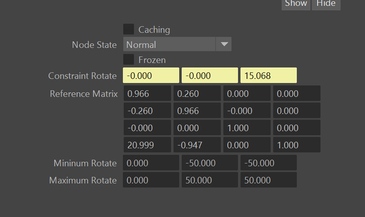

Hello, I created a new class which is derived from MPxNode.  Everything works fine with the compute function and the input/output.  However, when I select my node and I go in the Attributes Editor tab, my attributes are not sorted by categories.
My Node:
Locator Node:
Any clue why I don't have the Attributes drop down in my Node ("Node Behavior", Locator Attributes which should be MyNodeName Attributes) ?
