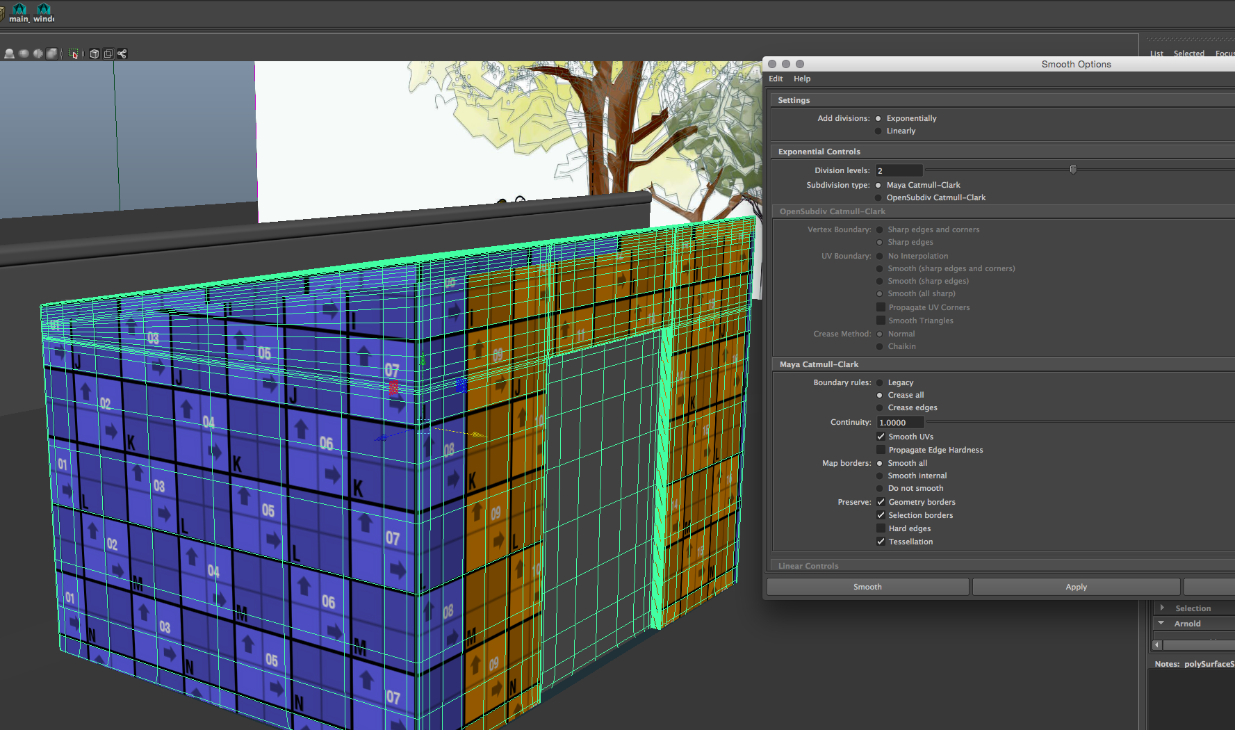

damaggio
See if these settings help you Starflesh...It's working the same in 2016 windows Sp4
Message 3 of 8

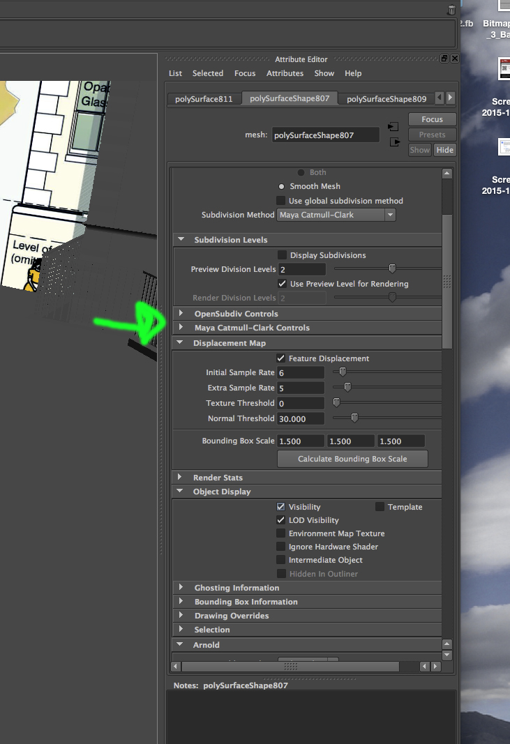

Thanks for this!
I was able to sort out the uv's by going into the smooth options and selecting smooth all. However it then applies all the subdivisions. I can't seem to find the option in the attributes editor in 2015?
Message 4 of 8
_sebastian_f
you´re nearly there, just open the according submenu;)
