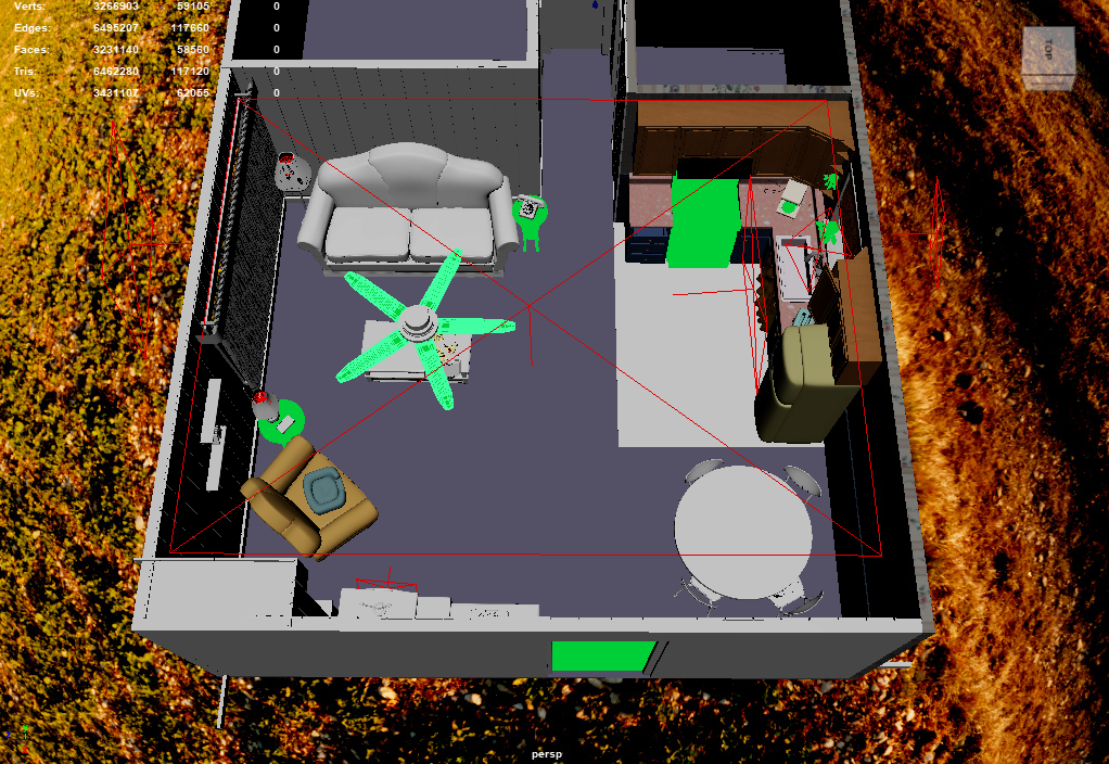

I have the exact same problem, but sparce meshes in an environment scene.
I tried cleaning everything, having shorter names for textures, there's no reference in the scene, every namespace is cleaned, delete History, Freeze Transform.
And yet, every time I open the scene, I have the exact same problem. About 8 meshes need to be reassigned their textures.

They are disconnected in the hypershade yes, like I can't Select Objects with Material from the texture
