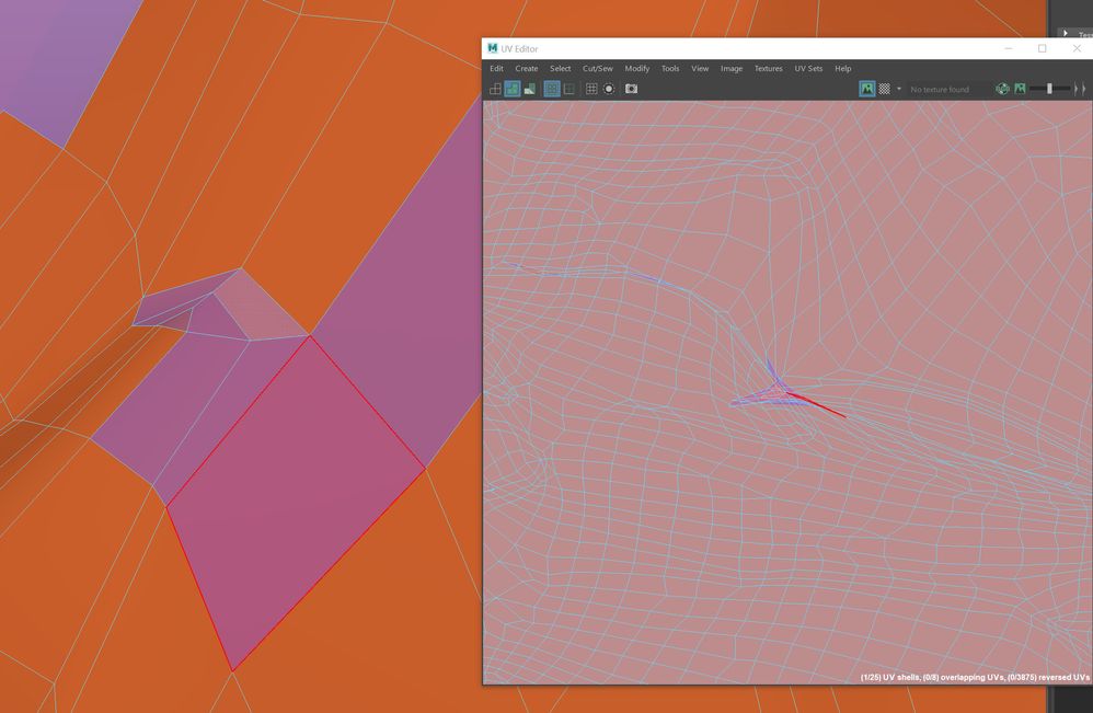

Hi, I found this thread after having this issue happen to me just now. I'm on windows 10 with an i9-9900k intel processor. I just wanted to say that I resolved the issue after looking at the geometry very closely after trying lots of different things. The cause of the problem was this one little patch of faces / verts going in and out of themselves. I fixed it by deleting some faces and remodeling that section.
Your reference photos show a fairly high density mesh, I would advise anyone that encounters this problem to double triple check you don't have some funky geometry going on.
