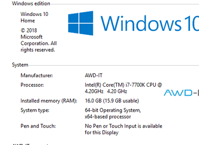

I am on an Asus machine actually? With a Windows 10 Home operating system,see below details.Operating SystemOperating System

My PC was advised by my Programme director and has the following specs.
