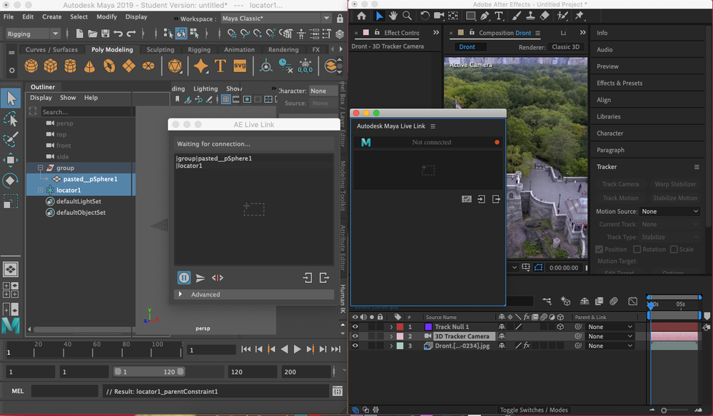

why my maya2019 live link can connection with aeScreen Shot 2019-04-28 at 2.46.49 PM.png
