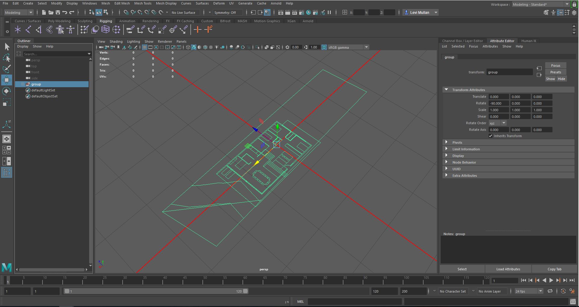

lhmullan
Hi Sean,
It imported the DWG (I just had to change the far clip plane for the perspective camera so it would display).
The lines are still all messed up though. In the attached image the curves are supposed perpendicular and here they are all wacky.
Not sure why.

mspeer
Hi!
This looks like rounding errors, could you upload the Maya scene-file?

Message 7 of 9
mspeer
Hi!
The more far away an object is from origin is the more coarse the calculation/precision will be (rounding errors).
Move the object(s) back to scene origin and the problem is gone.
1. Center Pivot
2. Bake Pivot
3. Move object to scene origin [0 0 0]
4. Freeze Transformations.

lhmullan
It worked! Thanks so much mspeer!
