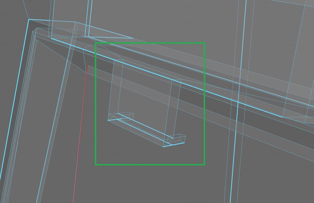

Message 11 of 19
Thank you very much.
I discovered something weird.
The cut edges I wanted to delete in Maya DO NOT SHOW UP in Roadkill.
Please refer to the attached pIn_Maya.jpgIn_Road.jpgictures (green rectangle).
Message 12 of 19
sean.heasley
Hi @Anonymous
Yeah this is most likely due to the geometry of your model. If there are any issues with the model things like Roadkill will pick up on them by giving results like the one you attached.
Once the model is properly fixed those issues should not appear.
