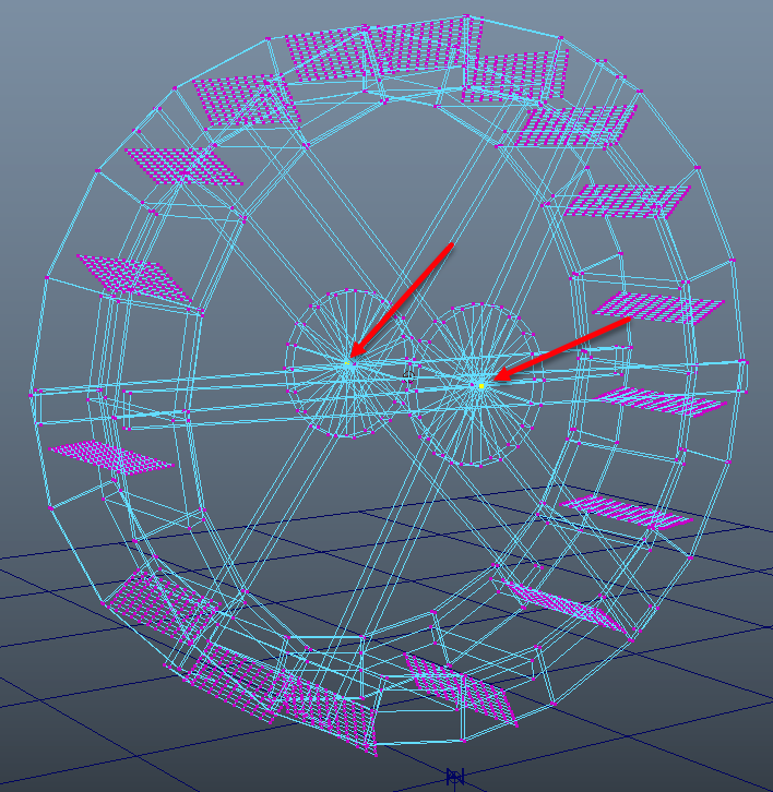

i made a water wheel with a particle and want the water wheel to be moving under the particle. i need a nconstraint but i wonder which one. do i use transform?

Roland.Reyer
turn the water wheel into an nCloth and use a preset to make it solid (e.g. solidRubber).
My water wheel was made from a cylinder so that I can use the center vertices for the transform constraint.
The transform constraint still has some flexibility which doesn't matter once the animation plays.

Roland.Reyer
The wheel needs to be ONE piece before you convert it to an nCloth, otherwise all pieces become independent objects. Combine should do it.
For the transform constraint select only the two vertices that are the axle of the wheel.

Roland.Reyer
Yes, I see.
1. In your scene there is still a lot of dynamics stuff that is not needed. Clean up your scene, delete everything but the water wheel geometry.
2. The water wheel is way too complex. There are 17 planes around the wheel, each with 100 faces that are not needed. If you simplify that your simulation will run much faster.
Then start from a clean scene.
Turn the wheel into an nCloth, apply the solidRubber preset.
Select only two (!) vertices on the axle for the transform constraint
Make the nParticle emitter.
Keep it simple so that you can see what affects what.

Roland.Reyer
Look, all these planes would work the same with just 1 facet.
Go into the settings of the polyplane to set the subdivisions to 1.
These are the two vertices that you should select for the transform constraint:
That will make sure that the wheel can rotate.

Roland.Reyer
First you do nCloth->Create nCloth (and apply the preset in the Attribute Editor).
Then you select those two vertices and go nConstraint->Transform Constraint.
http://help.autodesk.com/view/MAYAUL/2018/ENU//?guid=GUID-6FB65F16-528E-40F5-89D6-508CF654C547
