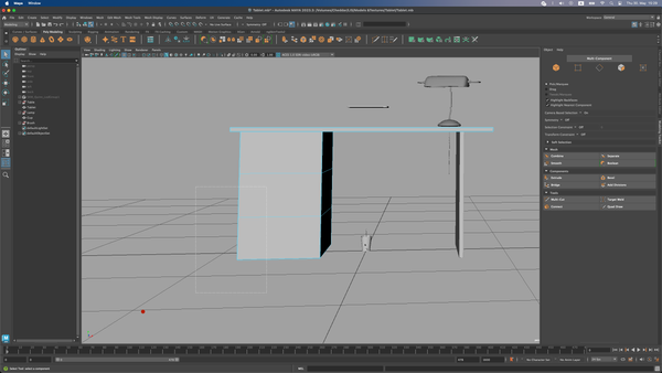

Pretty much the title. Upon exiting UV editing somehow the cursor is way off. I've attached the image: the red dot represents where my mouse actually is and the box shows where it "clicks". This has been an ongoing issue ever since I've had Maya on my computer. Only restarting the software helps to solve the problem, but it's not optimal. How do I go about this?

What scene units are you using?
Is your Mac an M1 or M2 mac?
Are you using a high dpi display?

have Asus ProArt PA278CV, I'm not sure if this one is high dpi? I'm on M2 chip. I also attached units I use below. Thanks!

So you are using a mouse (not a Wacom pen?) and your system/monitor specs are good. Are you able to recall what it is specifically you were doing in the UV Editor prior to the mouse cursor becoming offset? I wouldn't imagine this to be scene specific.
In the Maya Preferences, under the Display Category there is a checkbox at the bottom called Render OpenGL surfaces at full resolution. What is that set to? Is it on? (If it's on, you could try unchecking it then restarting Maya. If I remember correctly this will take Maya on Mac out of highDPI mode. Then you could try and see if the issue presents itself again).
I looked in our backlog for issues related to offset mouse cursors. I'll go over the reproduction steps for them in Maya 2023.3 (the version you are using from the attached picture above) and see if older issues that should have been fixed are resurfacing.
If possible could you get us a video or reproduction steps of it occurring on your side and upload it here to us?

Hello! Yes, I was only using my mouse. Your solution with unchecking the box worked for me, my goodnes, finally! Thanks a lot!
