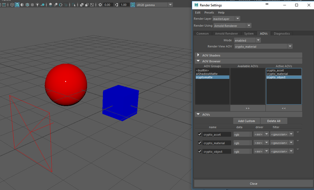

hi, i´m tryting to get the cryptomatte aov working but i can´t, its suposed to be correctly but when i start to render it appear blackCaptura.PNGCaptura1.PNGCaptura3.PNG
its arnold 5, and i dont know what i´m doing wrong... if you can help me would be apreciated!

Hi @Anonymous and welcome to the community!
For starters, have you tried increasing the intensity of your light and or using a different light like a SkyDome?
If that doesn't work, can you try rendering without the cryptomatte shaders? I just want to make sure the issue is specifically from the cryptomatte and not something else with Arnold.
Let me know if anything changes!

Stephen.Blair
Exactly what version of Arnold?
And check the Arnold log (with verbosity level = Warnings + Info) for errors and warnings. That's the first thing you should do, to avoid wasting time troubleshooting.

I encountered the same issue with Arnold 5.0.1.0, upon upgrading to Arnold 5.0.2.3, it works fine.
