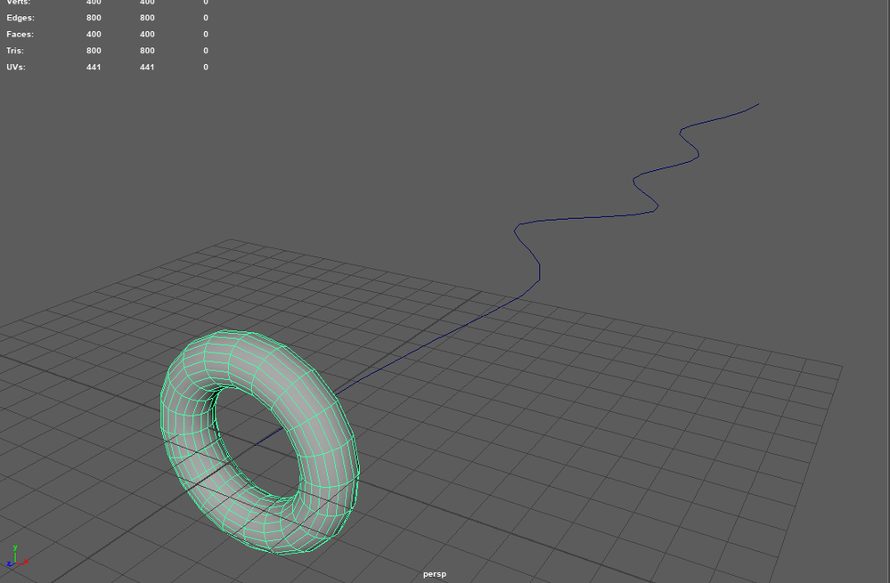

You need to create the Torus first. Once you have it scaled and as thick as you would like, create a CV curve along the path you would like to use. Then select half of the faces of the torus and shift select the curve then extrude. Once you've extruded be sure to increase the amount of divisions so it curves properly.

Here's some steps that should solve this for you!
Step 1: Create a torus
Step 2: Create a curve
Step 3: Select front half faces
Step 4: Shift+Select the curve
Step 5: CTRL+E to extrude and increase the divisions.
Please let me know if this helps or if you need any more assistance!
