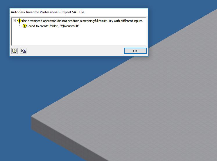

Message 10 of 25
Getting there....
Now getting an error (see attached)
Message 11 of 25
bradeneuropeArthur
Are you using inventor 2015?

Message 12 of 25
bradeneuropeArthur
this will do the trick:
    Public Sub ExportToSat()
        Set m_invApp = ThisApplication
        Dim oSATTrans As TranslatorAddIn
        Set oSATTrans = m_invApp.ApplicationAddIns.ItemById("{89162634-02B6-11D5-8E80-0010B541CD80}")
        If oSATTrans Is Nothing Then
        Exit Sub
        End If
        Dim oContext As TranslationContext
        Set oContext = m_invApp.TransientObjects.CreateTranslationContext
        Dim oOptions As NameValueMap
        Set oOptions = m_invApp.TransientObjects.CreateNameValueMap
        If oSATTrans.HasSaveCopyAsOptions(m_invApp.ActiveDocument, oContext, oOptions) Then
            oOptions.Value("ExportUnits") = 5
            oContext.Type = IOMechanismEnum.kFileBrowseIOMechanism
            Dim oData As DataMedium
            Set oData = m_invApp.TransientObjects.CreateDataMedium
            'oData.FileName = "C:\test\TEST.sat"
            Dim oSatFileName As String
            oSatFileName = Replace(m_invApp.ActiveDocument.FullFileName, ".ipt", ".sat") ' ipt to sat
            oSatFileName = Replace(m_invApp.ActiveDocument.FullFileName, "C:\", "\\hkeurvault\") ' c:\ to \\hkeurvault\
            MsgBox oSatFileName
            oData.FileName = oSatFileName
            Call oSATTrans.SaveCopyAs(m_invApp.ActiveDocument, oContext, oOptions, oData)
        End If
    End Sub
the drive c: was written to lower and must be upper C:

Message 13 of 25
It is now trying to create an odd folder string but maybe I didn't explain the current structure correctly....
We are using Vault and the local path for our files are C:\VAULT\DESIGNS\ and then we separate the folders further by customer and part number etc. The SAT files we need are for our brake press and need to be on the network server in a flat folder structure her \\hkeurvault\SAT_FILES\
It seems like the code is creating a mixture of the network path and the local path? I attached a couple of screenshots.

Capture6 = current error with new code

Yes still on Inventor 2015 until the end of the year
Message 20 of 25
@bradeneuropeArthur wrote:
please give me two examples of the export folder depending of the file exported.
The export folder will always be the same \\HKEURVAULT\SAT_FILES
All of the exported SAT files should be in the same folder with no additional sub folders
Hope it is clear
