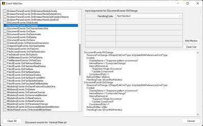

Maxim-CADman77
@mr_ensing
Inventor's SDK 'Developer Tools' contains 'Event Watcher' util that can be of some help.
Below is the result it gave me on Occurrence Suppress of the FeaturePattern
With all respect ... I don't think the solution based on 'DisplayName' should be considered as reliable.
... It was just a lucky coincidence for your particular case.
It won't work with any Inventor localization except English.
I believe you need to read each name out of the 'InternalNamesList' for presence of 'Suppress Single Occurrence'.
If Context.Value("InternalName") = "CompositeChange" AndAlso Context.Value("InternalNamesList").Length > 0 Then
	For Each sCmdName In Context.Value("InternalNamesList")
		If sCmdName = "Suppress Single Occurrence" Then
			' Do something
			Exit For
		End If
	Next
End If
