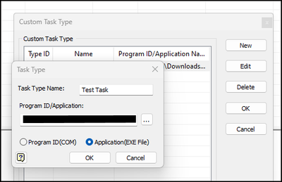

You can easily create custom EXE application in VB.NET and use them in TaskSheduler. Sample is in attachment and here is the screen shot from TaskScheduler configuration. Sample is for Inventor 2024.
This custom task only prints the PartNumber and full file name of all *.ipt files in given directory. It uses ApprenticeServer. For full Inventor it is similar, but slower and little bit more code.

I have found the issue.
There is a difference in the Task Scheduler when pasting the path of the .exe file in the dialog.
You must use the search button and then add the exe and not copy and past the path,
Thanks for supporting on this, appreciated...

That's it! 😉
You can use copy+paste, but you need to remove quotation marks ( " )
