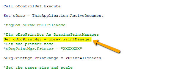

Message 25 of 38
karthur1
Thanks.  That got the code past that line, now it errors on a different line.  I get a "Type Mismatch" error on this line.
What can be changed to fix this?
Message 26 of 38
skyngu
Some text in green are comments. You have to change it to program code by deleting "  '  " sign
find help in vba.
Autodesk Inventor Professional 2019

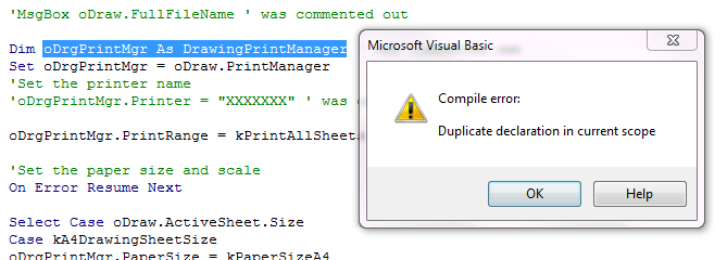

I added the oDoc.SelectSet.Select oDoc.ComponentDefinition like you show.
I also uncommented the Dim oDrgPrintMgr as .... line.  Now I get a duplicate declaration error.  If I comment it out, I get a type mismatch error.  Not sure where the problem is.
Message 29 of 38
skyngu
you have to check the code from top to bottom carefully, or get a fresh copy.
