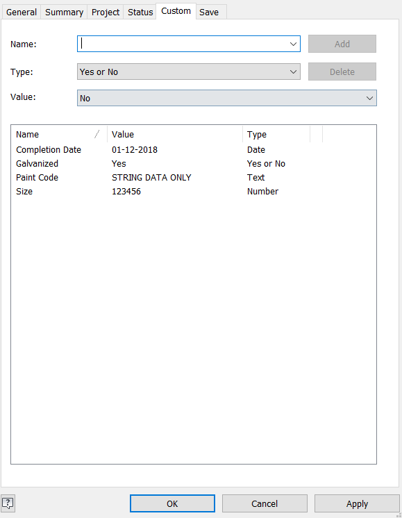

I am developing part of my rule to handle custom iProperties.
I need to retrieve "Type" data of iProperties.
Today.pngMy
My current rule (sample) is attached here to: I need to do with iProperty type information.
I appreciate if someone help me.

@RoyWickrama_RWEI,
Try below iLogic code to add custom properties depending on data type. Make sure that value is entered according data type.
For example:
Boolean - 'True - Yes' or 'False - No'
Date - 07-12-2018
Number - 123456
String - Any string value

Thanks for the question. Basically, currently, I need to view  (with a message box prompt) the type of the iProperty. However, I may explore all the options able to do. I will get back to you again.
Message 6 of 24
RoyWickrama_RWEI
Again, thanks for the fix. It is fine. With the help, I was able to add some try .. catch ... end try to avoid rule crashing.
I also need to extract type with a line of rule like below:
MessageBox.Show("TYPE: " & iProperties.Type("Custom", X_oProp_Array), "Title")
 But, error comes:
... Type' is not a member of 'Autodesk.iLogic.Interfaces.IiProperties'
Could you suggest a fix. Thanks.

RoyWickrama_RWEI
I explored a little bit more again. I think, this is not possible.
oCustomPropertySet = ThisDoc.Document.PropertySets.Item("Inventor User Defined Properties")
MessageBox.Show("Message, Before: " & X_oProp_Array, "Title")
oXX = oCustomPropertySet.Item(X_oProp_Array)
MessageBox.Show("Message" _
& vbLf & "Name: " & oXX.Name _
& vbLf & "Value: " & oXX.Value _
& vbLf & "Type: " & oXX.Type, "Title")
Type is retrievable, but useless because it is the same for all types (0339072 for all Text, Date, Number, Yes or No).
Several years ago, I had more problems like this, then I gave up. Coming back (I need to learn), I see Autodesk Inventor still has areas to develop.
Just information. Please let me know if you have some information.
Thanks.

@RoyWickrama_RWEI,
Try below iLogic code to get data type of custom property.
Sub Main()
	Dim doc = ThisDoc.Document
	Dim oProperty As Inventor.Property
	oProperty = doc.PropertySets.Item("Inventor User Defined Properties").Item("oText")
	Dim oValue As String
	oValue = oProperty.Value
	Try
		Dim oTime As DateTime
		oTime = DateTime.Parse(oValue)
		MessageBox.Show("Value is Date Type", "Property type")
		Exit Sub
	Catch
		 GoTo Numeric
	End Try
	Numeric:
	Try
		Dim oNumber As Integer
		oNumber = Convert.ToInt16(oValue)
		MessageBox.Show("Value is Number Type", "Property type")
		Exit Sub
	Catch
		  GoTo StringValue
	End Try
	StringValue :
	If oValue = "True" Or oValue = "False" Then
		MessageBox.Show("Value is Boolean Type", "Property type")
	Else
		MessageBox.Show("Value is Text Type", "Property type")
	End If
End Sub

it shouldnt be still a number though. if you are adding as a number 123456, it will be a number but if you add as a string "123456" it will be a string.
I did a bunch of iProperty work recently and the function i made to determine the Type was needed because all of my values were originally added as text, even long numbers. I needed the Type check to add in the type and then added the value as that iProperty value as a Type like this:
Dim customPropSet As Inventor.PropertySet = Doc.PropertySets.Item("Inventor User Defined Properties")
Dim ValueIn As Object = GetPropertyType(PropertyValue)
Try
   Dim prop As Inventor.Property = customPropSet.Add(ValueIn, PropertyName)
Catch ex As ArgumentException
   Dim prop As Inventor.Property = customPropSet.Item(PropertyName)
   prop.Value = ValueIn
End Try
i was setting the ValueIn as the as the value and the type by using the GetPropertyType() function and then when passing into the iProperties, it was setting the value as they Type.
