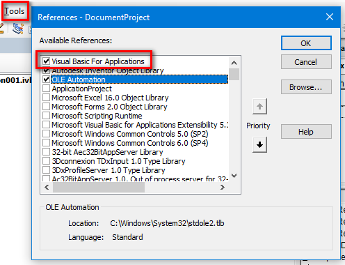

Message 16 of 18
bradeneuropeArthur
Have you set all references correctly for VBA:

Message 17 of 18
Yes, the references are set.
