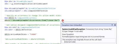

Here's the message I get.

Here is the code that is not working.
        Dim oDoc As AssemblyDocument
        oDoc = g_inventorApplication.ActiveDocument
        Dim oAssemblyCompDef As AssemblyComponentDefinition
        oAssemblyCompDef = oDoc.ComponentDefinition
        ' Specify an occurrence to change its active model state.
        Dim oOccu As ComponentOccurrence
        oOccu = oAssemblyCompDef.Occurrences.Item("Linear Bar")
        ' Get native document ComponentDefinition of occurrence.
        Dim oOccuDef As ComponentDefinition
        oOccuDef = oOccu.Definition
        oOccu.ActiveModelState = "CA400"

Looks like you may just need to switch from using the regular Item property (only accepts Integer/Long), to using the ItemByName property for that one line of code.
