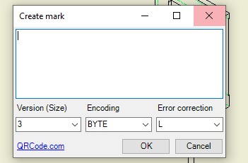

I have an addin that create a Qr code .
this is the Addin
i want to write the part number in the box but automatic without write manually
This is my Rule that call the addin

What next? Do you want to show this QR code somewhere on drawing?
For this reason is there (in the XTools addin) automatic property conversion. QR code is stored as text in user defined property. Later on you can create sketched symbol or Titleblock, which can display this converted property value.
If you need more info, you can see the documentation and samples installed with the addin.

Where is the code for the Dialogbox?
We need to have it for filling the partnumber in.

Only ways i can think of
Refer to samples / product support for the addin you installed
Use the Win API to get the window / hwind ID and access the form that way (I dont recommend this as its not always reliable and is complicated)
Create your own addin; utilising something like ZXing / open source tool as the basis and integrate it into your own form.
