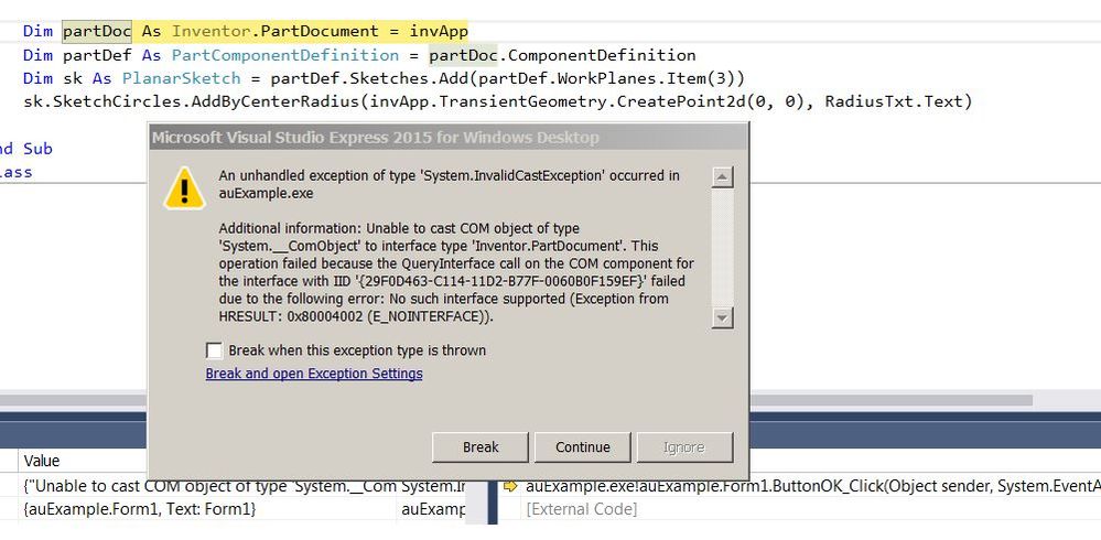

Hello
I've followed a post on AU to create an Inventor add in.
Used a downloaded 2018 pre-configured template (for visual studio) & saw this error:
then started again without the template - like the tutorial!
Tricky to know what to try next..
Regards
Andrew
378 Views
andrew_canfield
i missed a word out. Doh
should be
Dim partDoc As Inventor.PartDocument = invApp.ActiveDocument
bradeneuropeArthur
Dim PartDoc as inventor.PartDocument= invApp.ActiveDocument

bradeneuropeArthur
@andrew_canfield
That was close.
Good to hear you solved it!
