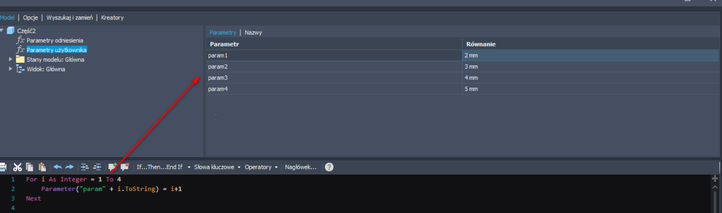

Message 7 of 9
m_baczewski
Try this code if you have defined a user parameters in document.
For i As Integer = 1 To 4
	Parameter("param" + i.ToString) = i+1
Next
