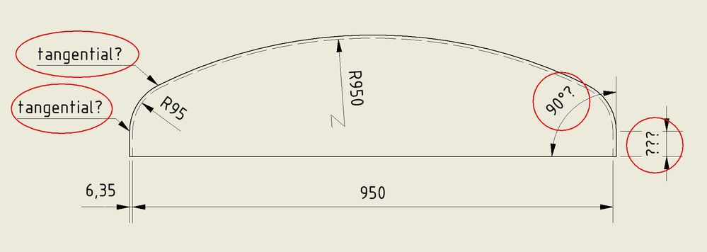

I'm sending a drawing to explain it better.
The result of the routine has to be radius 575 mm. Thank you for your attention! 03.05.0004.PNG03.05.0003.PNG
Message 7 of 10
Ralf_Krieg
Hello
In such a case it would be much more helpful to upload the ipt file. I think there are some dimensions missing (please see picture).
Anyway, when your parts are always a revolve, there could be an alternative way we can try.

As long as the unwrapped face is a circle, take the second scipt. The first isn't stable and would not use it anymore.
