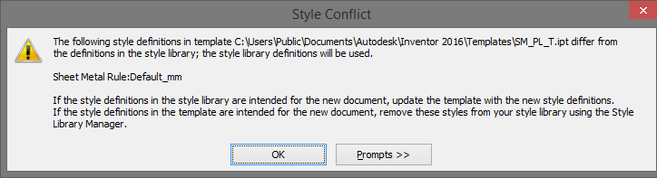

Question: when you open your template, do youhave an message like this?

Hi Carlos, I overlooked your last question, no I do not get that message, probably because of a setting of a prompted message. I have tried to look for it but unable to find it quickly.
