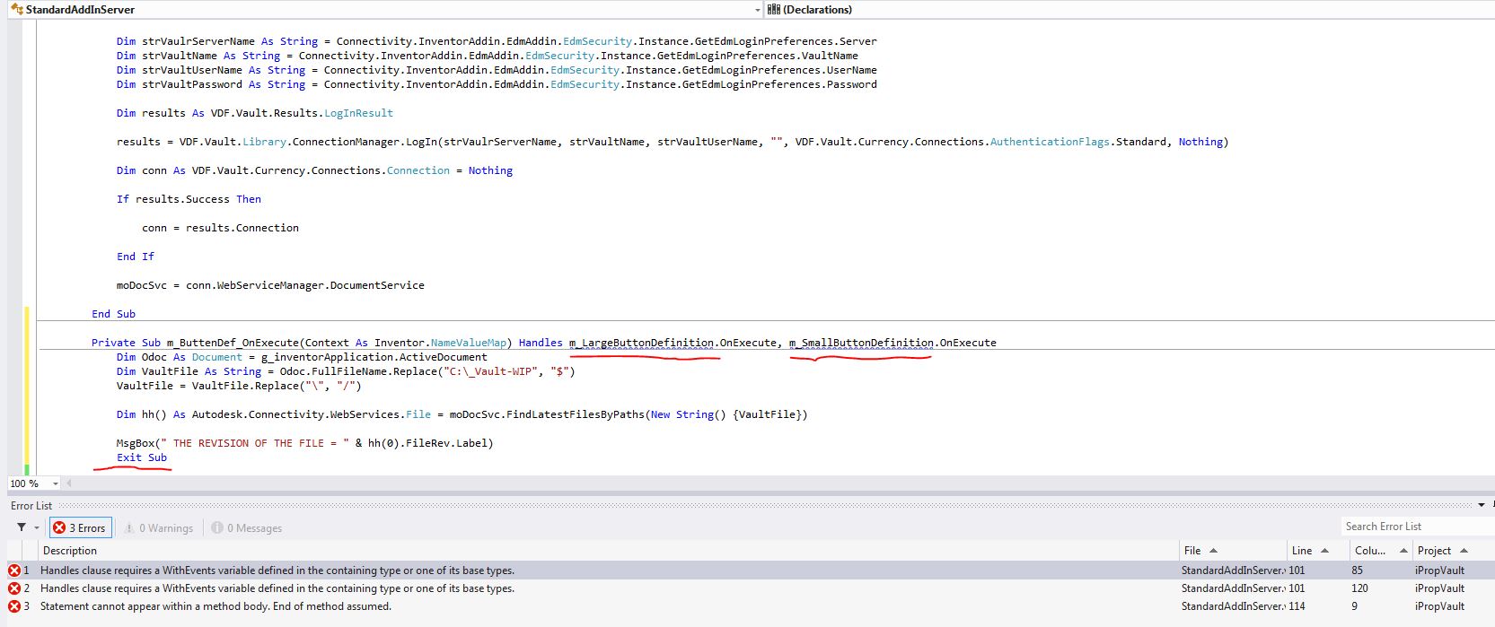

Thank you for you reply. I've managed to create a project from the Inventor 2017 add-in template, compile it and see it load in Inventor (that's the furthest I've ever got to in creating my own add-in !!)
I'm now running into errors however when attempting to add your code, see attached image. It's like its not recognizing the imported references.
Could you perhaps look at my project file and see where I'm going wrong? (see attached)
thanks

Message 9 of 29
Thanks, that's taken care of the references. Just down to 3 errors left now (see attached image)
Appreciate the help!
Message 10 of 29
@bradeneuropeArthur
I think I traced it back to here. I'm not sure how to reference an icon/bitmap for my button?

bradeneuropeArthur
You need to add an icon to your project resources. Than add this with icontoipicture to your button.
If needed I can show you how tommorow.

Message 19 of 29
@bradeneuropeArthur
I have made that change to the line you suggested and still had no success.
I tried moving the contents of the SetupUserInterface sub into  the m_sampleButton_OnExecute private sub and it now gets to the last message box.
Although the FileRev.Label is blank Smiley Frustrated
I checked vault and it should have a value of "A"
see code below:
Private Sub m_sampleButton_OnExecute(Context As Inventor.NameValueMap) Handles m_sampleButton.OnExecute
Dim strVaulrServerName1 As String = Connectivity.InventorAddin.EdmAddin.EdmSecurity.Instance.GetEdmLoginPreferences.Server
Dim strVaultName1 As String = Connectivity.InventorAddin.EdmAddin.EdmSecurity.Instance.GetEdmLoginPreferences.VaultName
Dim strVaultUserName1 As String = Connectivity.InventorAddin.EdmAddin.EdmSecurity.Instance.GetEdmLoginPreferences.UserName
Dim strVaultPassword1 As String = Connectivity.InventorAddin.EdmAddin.EdmSecurity.Instance.GetEdmLoginPreferences.Password
Dim results1 As VDF.Vault.Results.LogInResult
results1 = VDF.Vault.Library.ConnectionManager.LogIn(strVaulrServerName1, strVaultName1, strVaultUserName1, strVaultPassword1, VDF.Vault.Currency.Connections.AuthenticationFlags.Standard, Nothing)
Dim conn1 As VDF.Vault.Currency.Connections.Connection = Nothing
If results1.Success Then
conn1 = results1.Connection
MsgBox("Connected to Vault")
End If
moDocSvc = conn1.WebServiceManager.DocumentService
Dim Odoc As Document = g_inventorApplication.ActiveDocument
MsgBox(Odoc.FullFileName)
Dim VaultFile As String = Odoc.FullFileName.Replace("C:\_Vault-WIP", "$")
VaultFile = VaultFile.Replace("\", "/")
MsgBox(VaultFile)
Dim hh() As Autodesk.Connectivity.WebServices.File = moDocSvc.FindLatestFilesByPaths(New String() {VaultFile})
MsgBox(hh(0).Name)
MsgBox(" THE REVISION OF THE FILE = " & hh(0).FileRev.Label)
Exit Sub
End Sub
