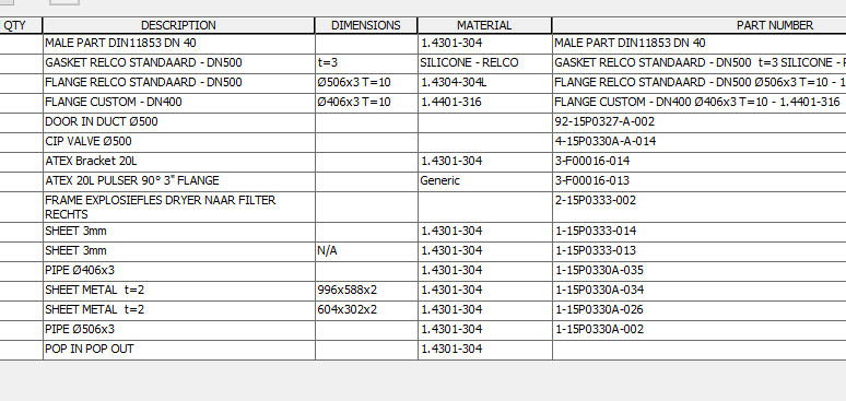

Hi!
I want to auto sort our partslists with iLogic and I made a beginning to find out what we want.
I included a screenshot I can explain myself better.
We want to sort on 2 coloms simultanious kinda.
We want to sort the numbers by the first number (format = No-ProjNo-001)
First sorting job is Partnumber
  • 94-projNo-x
  • 92-ProjNo-x
  • 4-ProjNo-x
  • 2-ProjNo-x
  • 1-ProjNo-x
  • 3-ProjNo-x
  • A
  • B
  • C
  • D
After that we want to sort by description
The 94 -> 92 -> 4 -> 2 -> - etc needs to be sorted but we want to group the descriptions.
Example
1-part-009 = Sheet 2mm
1-part-007 = Sheet 2mm
1-part-269 = Sheet 5mm
1-part-100 = Sheet 6mm
So here the description is more inportant than the last 3 digits of the partnumber.
Okay so. Here's my question
How can I sort these things  seperatly and then combine them again?
I'd like to filter just the first digit of the partnumber and sort that and after that sort the small 'blocks' of 94's 2's 1's etc
Anyone that can point me in the right direction?

I made this for now but this sorts the whole partnumber and places tha alphabetical partsnumber above the numbered partnumbers.

this is not possible trough the standard Sort function.
The PartsList.sort function is the same, like what you can done manually in your PartsList on your Drawing.
There you can enter max. 3 Sort criterias. But what you want is customized search function. Thats not so easy.
In your case, only this should be possible ( numbers before characters acsending or descending)

The "code friendly way" is to write an iComparable sort method to be called with a "List.Sort" in order to spit out at sorted list, then you need to use that outputted list to rearrange your browser nodes.
It's a lot of work.
Solution 2:
You could also just write your own comparison that runs on the parts list and sorts them based on a multi-tiered criteria sort. Again, a lot of work and a lot of understand of what goes on.
Solution 3:
You're probably better off assigning a "sort priority" iProperty in your BOM so it can cluster the things in a group.ie;
Part Number - Sort Priority value
Project number - 1
Sheet metals - 2
Misc material - 3
Then you sort your BOM by 'Sort priority' and then by Part Number' using the built in features, without API.
I highly recommend you work with solution 3.
