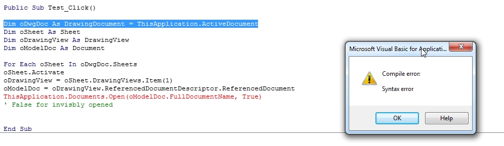

Hi
Thank you for the help...but i am getting the error:
2015-04-23 19_57_48-Microsoft Visual Basic for Applications - 09042015.ivb [running] - [ExportFromID.jpg
Message 4 of 9
MechMachineMan
Hmmm. Not at clue. It works perfectly for me just like that inside of inventor.
It could be because it is written in vb.net instead of vba, so it might be missing Call in front of the last line.

Yes, it works as Ilogic rule (VB.Net) but I need this for my macro so i need this in VBA.....

Ok i didi it 🙂
Dim oDwgDoc As DrawingDocument
    Set oDwgDoc = ThisApplication.ActiveDocument
Dim oSheet As Sheet
Dim oDrawingView As DrawingView
Dim oModelDoc As Document
For Each oSheet In oDwgDoc.Sheets
oSheet.Activate
Set oDrawingView = oSheet.DrawingViews.Item(1)
Set oModelDoc = oDrawingView.ReferencedDocumentDescriptor.ReferencedDocument
Call ThisApplication.Documents.Open(oModelDoc.FullDocumentName, True) ' False for invisbly opened
Next
 And it works 🙂
Thanks for help
