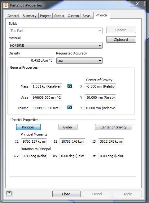

I have several iLogic driven templates set up for products, and have noticed since getting Inventor 2018 that rounding a custom iProperty to 0 decimal places, still displays it with .0 , even though Inventor does not recognise the .0.
For example, we have a custom iProperty for Mass in Air, when we run the 'Update Weights' rule, an input box asks for the number of decimal places required. When selecting '0' the resulting iProperty would read as 111.0 for example. Inventor 2017 did not have the .0 displayed.
If I try and remove the .0 zero by asking to go right 2 places, the iProperty would then give me '11'  which makes me think Inventor is not seeing the .0 even though it is displayed.
The attached screenshots show the actual mass, the 'WIA' iProperty with 2 decimal places, and with 0 decimal places.
The 0 decimal places displays '2.0' even though it should read '2'
Anyone else come across this or have a fix for it?

It doesn't work, already tried that. The custom iProperty still has the .0 on the end.
Inventor 2017 didn't have this issue even with having the precision at 3 DP in document settings.

Think inventor changed a little:
this is working:
Dim Rounding As Integer
Rounding = InputBox("dd", "dddd", "0")
Dim m As Decimal= iProperties.Mass
MsgBox(Round(m,Rounding))
iProperties.Value("custom","WIA") = Round(m,Rounding).tostring
Regards,
Arthur Knoors

HI,
Yeah, Inventor is up to date with the latest patch.
I wonder if your code works better as your adding the "kg" on to the end of it where mine was just a number?
I'll try my code that way to see If that also fixes the error.
