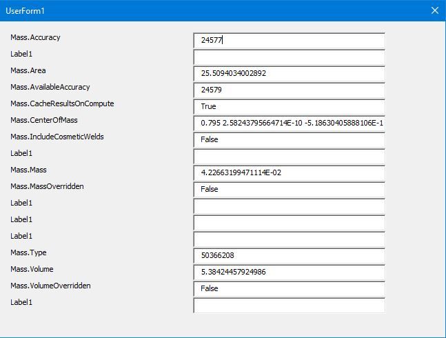

isocam
Can  anybody help?
I have the following line of code in a VBA macro to display the iProperties dialog box
ThisApplication.CommandManager.ControlDefinitions.Item("AppiPropertiesWrapperCmd").Execute
Is it possible to open the iProperties dialog box and automatically show the "Physical" Tab without having to select it manually?
Many thanks in advance!

bradeneuropeArthur
Unfortunately think it is not.
Why not creating your own dialog with the physical properties on it?

bradeneuropeArthur
I have added some Vba code:
For a userform.
Private Sub UserForm_Activate()
Dim a As Application
Set a = ThisApplication
Dim b As PartDocument
Set b = a.ActiveDocument
Dim Mass As MassProperties
Set Mass = b.ComponentDefinition.MassProperties
TextBox1.Text = Mass.Accuracy
'TextBox2.Text = Mass.AchievedAccuracy(
TextBox3.Text = Mass.Area
TextBox4.Text = Mass.AvailableAccuracy
TextBox5.Text = Mass.CacheResultsOnCompute
TextBox6.Text = Mass.CenterOfMass.X & " " & Mass.CenterOfMass.Y & " " & Mass.CenterOfMass.Z
TextBox7.Text = Mass.IncludeCosmeticWelds
'TextBox8.Text = Mass.IncludeQuantityOverrides
TextBox9.Text = Mass.Mass
TextBox10.Text = Mass.MassOverridden
'TextBox11.Text = Mass.PrincipalMomentsOfInertial
'TextBox12.Text = Mass.RadiusOfGyration
'TextBox13.Text = Mass.RotationToPrincipal
TextBox14.Text = Mass.Type
TextBox15.Text = Mass.Volume
TextBox16.Text = Mass.VolumeOverridden
'TextBox17.Text = Mass.XYZMomentsOfInertia
'LABELS
Label1.Caption = "Mass.Accuracy"
'Label2.Caption = "Mass.AchievedAccuracy"
Label3.Caption = "Mass.Area"
Label4.Caption = "Mass.AvailableAccuracy"
Label5.Caption = "Mass.CacheResultsOnCompute"
Label6.Caption = "Mass.CenterOfMass" ' & " " & Mass.CenterOfMass.Y & " " & Mass.CenterOfMass.Z"""
Label7.Caption = "Mass.IncludeCosmeticWelds"
'Label8.Caption = Mass.IncludeQuantityOverrides
Label9.Caption = "Mass.Mass"
Label10.Caption = "Mass.MassOverridden"
'Label11.Caption = Mass.PrincipalMomentsOfInertial
'Label12.Caption = Mass.RadiusOfGyration
'Label13.Caption = Mass.RotationToPrincipal
Label14.Caption = "Mass.Type"
Label15.Caption = "Mass.Volume"
Label16.Caption = "Mass.VolumeOverridden"
'Label17.Caption = Mass.XYZMomentsOfInertia
End Sub
I have added the Project for VBA too:
load this into your VBA environment.
