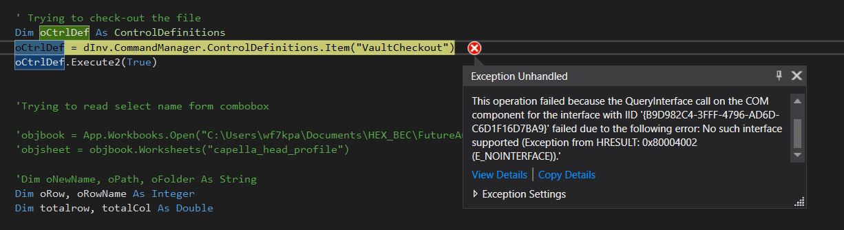

I am using the below code.
I am able to open the file successfully and after that the code throws the error. I believe the opened file is the selection that you had asked. Right? If not, then I am not aware what selection are we talking about.
Dim FileName As String
        FileName = "C:\V\HEX\Designs\GPHE Global Product Platform\FRAMES\CAPELLA\C063MA60A\C063MA50A-F-P.ipt" 'ComboBox1.Text
Dim odoc As PartDocument
odoc = dInv.Documents.Open(FileName)
        ' Trying to check-out the file
Dim oCtrlDef As ControlDefinitions
oCtrlDef = dInv.CommandManager.ControlDefinitions.Item("VaultCheckoutTop")
oCtrlDef.Execute2(True)

bradeneuropeArthur
The code in the screenshot is different. Vaultcheckout!

Message 13 of 13
I tried with 'Vaultcheckout' too. Same issue is coming.
