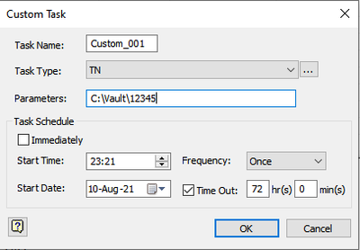

As you can see in the TS custom task you can give one parameter with it!
We could use the parameter "c:\your workspace" for it.
Then I can do something like this
For Each file in folder
Do create thumbnail
For Each folder In folder loop...
Would this be an idea

I have a CustomTask Ready for you!
Example of the Path:

Hello bradeneuropeArthur,
  I was finally able to try this out this morning, but it didn't seem to do anything.  Here is the process I used:
  1. Within Autodesk Vault, I did a Get... w/Check Out on 100 Inventor DWG files which do not have their thumbnails
  2. Placed the TaskShedulerThumbNail.exe in the C:\ADSK_VAULT folder.
  3. Create Task, Custom Task..., then pointed to the following settings.
It runs for 4-5 seconds with no errors, then stops showing Complete - Successful, but there are no changes in the 100 files within the subfolders.
Bryan
