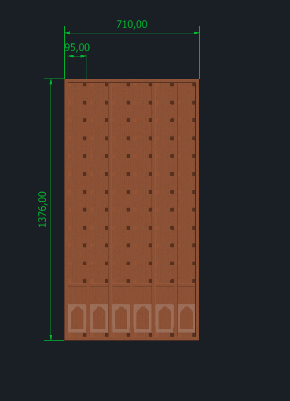

  1. Have you faced any issues with the oGDims.Retrieve method, or do you know of constraints that might cause this error?
  2. Any best practices or insights when working with model dimensions in Inventor, especially within assembly documents, would be invaluable.
    To give a clearer picture of the issue and setup, I've added images for reference. You can see both the part level and assembly, as well as drawing images.
 Thank you very much and speak soon
Anthony5375F
Hi @WCrihfield,
Thanks for the initial assistance on the iLogic rule. I've been trying to expand upon the rule you provided, but I'm still encountering a few issues. I attached some images in my previous post that might help clarify the situation. Could you possibly take another look when you have some time?
Appreciate your expertise on this matter.
