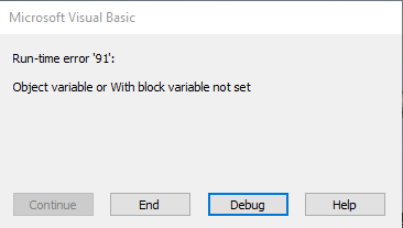

I recently upgraded to 2022 cad from 2019. I have the following lines that I run to unload the Vault Add-in before subroutines to avoid all the vault "Do you want to check this out" prompts for each file, and then reload afterward.
Sub VaultAddIn()
    Dim strResponse As String
    strResponse = MsgBox("Yes=Load, No=Unload, Cancel=Do Nothing", vbYesNoCancel, "Do you want to load/unload Vault Add In?")
    Select Case strResponse
        Case vbYes
            ThisApplication.ApplicationAddIns.ItemById("{48B682BC-42E6-4953-84C5-3D253B52E77B}").Activate
        Case vbNo
            ThisApplication.ApplicationAddIns.ItemById("{48B682BC-42E6-4953-84C5-3D253B52E77B}").Deactivate
    End Select
End Sub
When the .Activate line is run, I get the following error. I used to get this error in INV2019 about 10% of the time, but now in 2022 I get it every single time. I want to add that I get this error when I have an assembly opened. If I open Inventor and no file is open, I can unload/load the vault addin as much as I want through the API with no errors.
If I load/unload via the GUI from Tools->Add-Ins, the vault fails to load properly, again if an assembly is already opened. I can still check files in/out, but several ribbon buttons are missing from the Vault Tab. If I pull the GUI up again, it says the Vault Add-in is still unloaded. Below are some UI snips to display the odd behavior.
Vault TabVault Tab
Context Menu, Extra "Vault"Context Menu, Extra "Vault"
I noticed that the vault add-in is in the \ProgramData folder, while all the other add-ins are in \Program Files. Is this supposed to be here? Could the fact that this folder is Hidden be causing this problem? My user account has full admin privileges, and also running INV as admin makes no difference.
Any help with this would be greatly appreciated. Many thanks in advance.

rcolon9E4ZX
@bradeneuropeArthur ,
Thank you for the response. That is fascinating. I referenced the addin with an object per your comment and now I get no error.
There seems to be some changes to how VBA operates in this version. For example, I have public variables I use for Excel declared with this: Public oExcel As Object, oWorkbook As Excel.Workbook. I could create Excel applications and workbooks with no problems in INV2019 and INV2022. I then updated to INV2022.1.1, and my code kept failing on this line: Set oWorkbook = oExcel.Workbooks.Add. Nothing had changed with my references, I only updated inventor. The way I got it to work again was changing how I declared the workbook object: oWorkbook As Object. How can something like this be affected by an INV update?
Thanks again for the help.

rcolon9E4ZX
I actually got this same error again. In my implementation, I deactivate first, then active at the end. Here is my code. It is basically showing a userform that allows the user to pick the macro they want to run. Only certain macros need the vault add-in unloaded.

'Reactivate Vault is failing
If boolUnloadVault = True Then aai.Activate 'ThisApplication.ApplicationAddIns.ItemById("{48B682BC-42E6-4953-84C5-3D253B52E77B}").Activate

rcolon9E4ZX
How will aai.Activate work if the object aai is set to nothing beforehand?
Rafael
Message 9 of 14
bradeneuropeArthur
you need to release the memory after unloading the add in.

rcolon9E4ZX
I get the following error because the object is not set at the line aai.Activate.
This way seems to work though. I have executed multiple times in a row with no error.
Dim aai As ApplicationAddIn
Set aai = ThisApplication.ApplicationAddIns.ItemById("{48B682BC-42E6-4953-84C5-3D253B52E77B}")
aai.Deactivate
Set aai = Nothing
Thank you.
