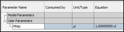

Is this possible?
I've had a look at a few articles, but can't see anything that suits.
What I ultimately want to do, is to establish whether a file has more than one Model State & if it does, return a boolean value of 1 to a custom parameter.
Thanks in advance.
302 Views
bradeneuropeArthur
This will do:
It will create a PMst parameter with a value of 1 if there are more than one Modelstate in the Assembly.
Dim a As AssemblyDocument = ThisAssembly.Document
Dim c As AssemblyComponentDefinition = a.ComponentDefinition
Dim UPs As UserParameters = c.Parameters.UserParameters
Dim Up As UserParameter
If c.ModelStates.Count>1 Then
Try
	Up = UPs.Item("PMst")
	Catch
	UPs.AddByValue("PMst",1,"ul")
	End Try
End If
Regards,
Arthur Knoors
