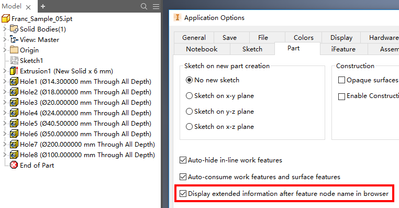

How difficult would it be to place the hole diameter in the name of the hole feature to one decimal place?
For example re-name a Ø14.3 hole to "HoleD14.3".
This would make this code perfect Smiley Happy
Franco
GMT +08:00
Message 59 of 73
smilinger
Can be complicated for countersink holes, I suggest turn on the inventor option to show the infomation automatically.
