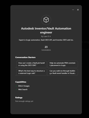

liam.dewhurstNMKYG
I'm busy training this custom GPT to be better and better at writing automations for me.
I co-wrote a code for finding sneaky drawings that didn't fully link to the part in inventor:
Here's the logic
- check local for an .idw (same name)
- check vault for an .idw thats the same name
- And then ping the "has drawing" to find a drawing on vault.
- and if it draws a blank, it starts a dialogue box for selecting a template and auto places the parts.
It's getting reasonably good. Jump in and use it, and fire me codes or training if you want and I'll keep adding to this tool. (though there may be a better one out there?)
I just pulled any training doc I could find for ilogic or vault API and added it in. I'm up to starting to create custom dll add-ins, but I just need to book our software engineers in to aid in this (slightly out of my personal depth here)
