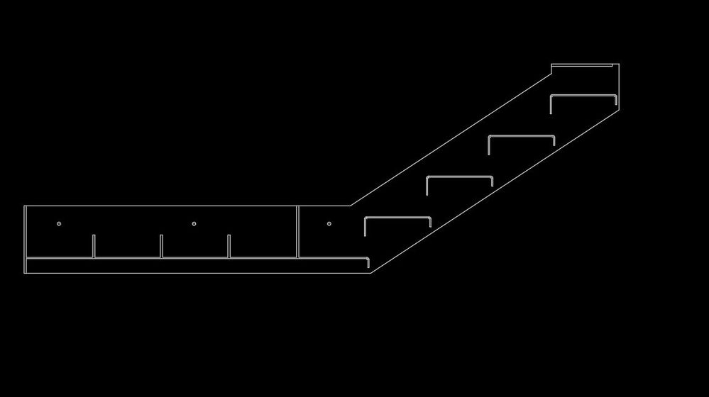

i covert a standard .ipt to sheet metal , it seems like the part will come out mirror se pictures, Mirror 1.JPGMirror 2.JPG

i add this when i got color, but i still miss to remove bend lines i also see that i must make arc center invisible
and make part not mirror as picture above
sOut = "FLAT PATTERN DXF?AcadVersion=2004&OuterProfileLayer=Cut&OuterProfileLayerColor=0;255;0&featureprofilesdownLayer=Scribe&featureprofilesdownLayerColor=255;0;255&interiorprofilesLayer=Cut"
Message 14 of 30
EMVC
Hello
I have tried to modify it a little bit, it works but it is not perfect modify se in red
I hope now to implent so part dont comes out as mirror se picture above

i was played a little bit and it seems like i have front view i wish to have back view instead
what lines could be added

EMVC
Hello
Here is pictures the first one below is right the second one with green and pink color is mirror, thats my cut and scribe lines, like it is now it will get scribe on the wrong side in plasma, so i mirror in autocad
One question, can qty from i propert be added
